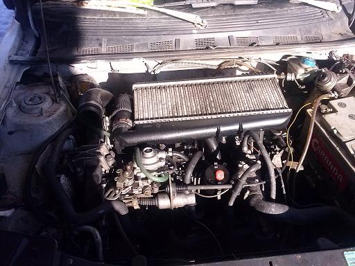

Hi! I'm the prowd owner of an 1992 peugeot 309 it was an xad model now it has many parts form gti like seats, dashboard, outside ornaments etc and an xud7te intercooled engine with an bosch fuel pump 190 atm renault bosch injectors garret t2 turbocharger!

I have the bosch fuel pump beacuse is easyer to play with the boost and it's more reliable/ i'm preparing one from an 406 1.9 td to put on my car maybe i will trow an 11 mm head for more fuel but for now it's enouch for the garret t2 turbocharger an fmic.

I now a guy who is puting a T25 from a 2.0 TCT with the machined genuire T2 hot body, the engine will be a 2.1 TD12 with a 1.9 head.
